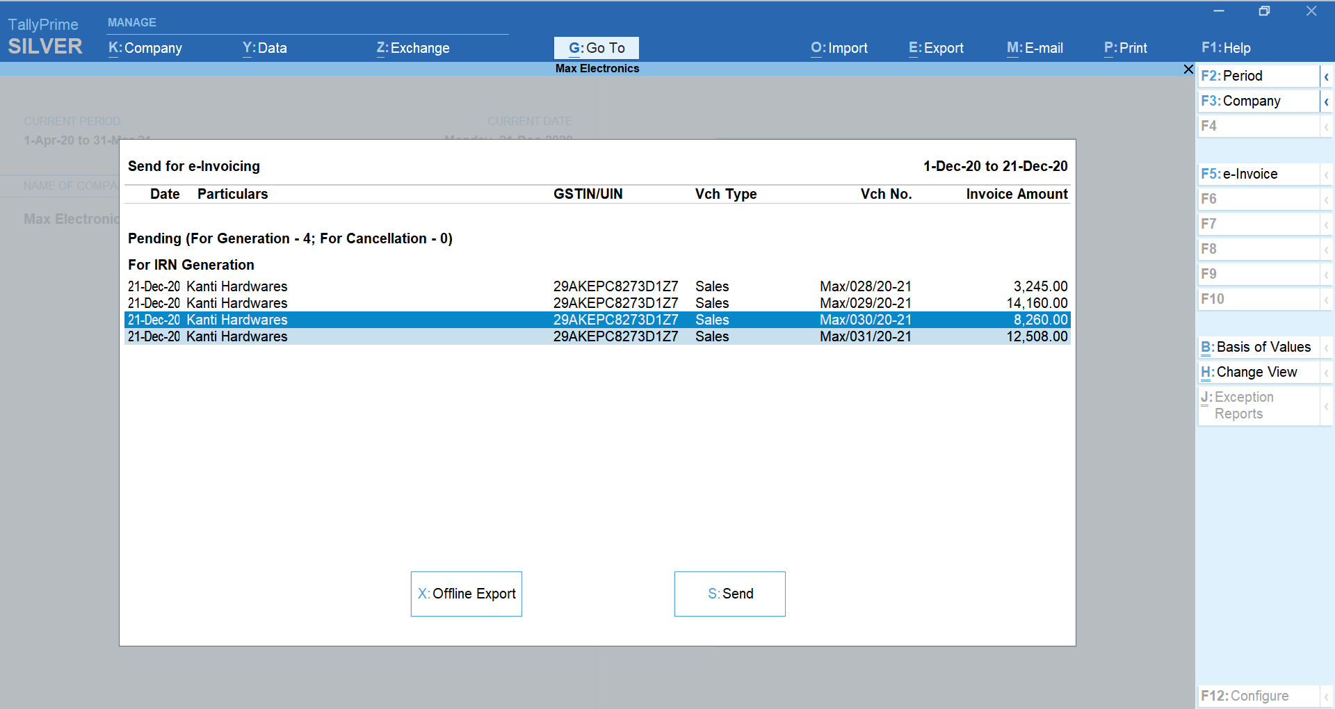

  • Single or bulk e-invoice
You can either generate an e-invoice in the flow of recording invoice  or do this in bulk for multiple invoices together. TallyPrime will adapt to your preference
Generating bulk e-invoice in TallyPrime

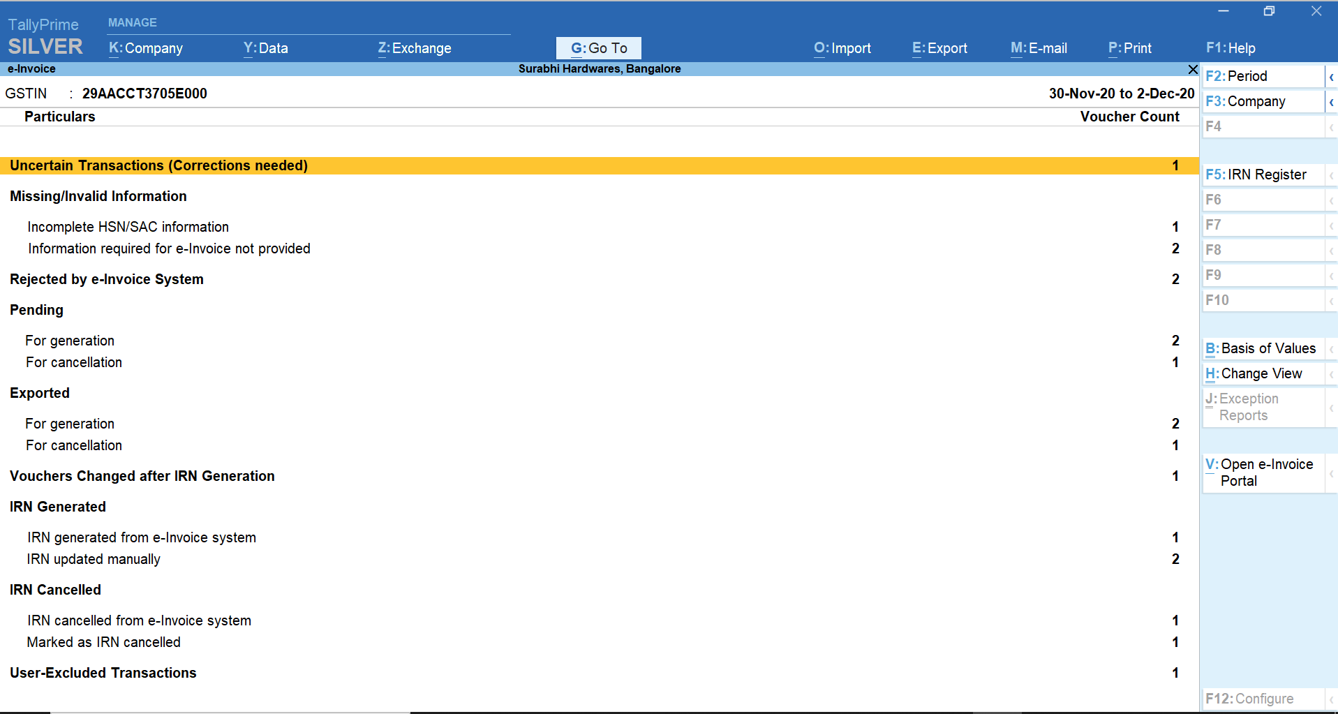

  • e-invoice reports
TallyPrime’s exclusive report will give you a complete view of the status of your transactions with respect to e-invoicing. You can quickly get to the completed, pending, cancelled etc.
e-Invoice report in TallyPrime

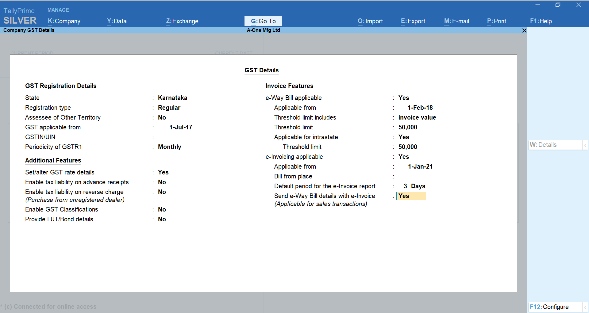

Generating e-invoice with TallyPrime is extremely simple. With a one-time setup you can start generating and printing e-invoices within seconds. You wouldn’t need to change the way you work at all as TallyPrime adapts to your working style and gives you the flexibility to generate reports your way, in just 3 steps: Enable, record and print.
  • First, enable e-invoicing applicable to ‘Yes’. Make E-way bill also to ‘Yes’, if applicable

How to enable e-invoice in TallyPrime?
e-Invoice can be enabled in TallyPrime in three quick steps:
  • Press Alt+G (Go To) > Alter Master > Voucher Type > type Sales > press Enter. Alternatively, Gateway of Tally > Alter > Voucher Type > type or select Sales > press Enter.
  • In the Voucher Type Alteration screen for Sales, set Allow e-Invoicing to Yes.
  • Press Y to accept the screen.
