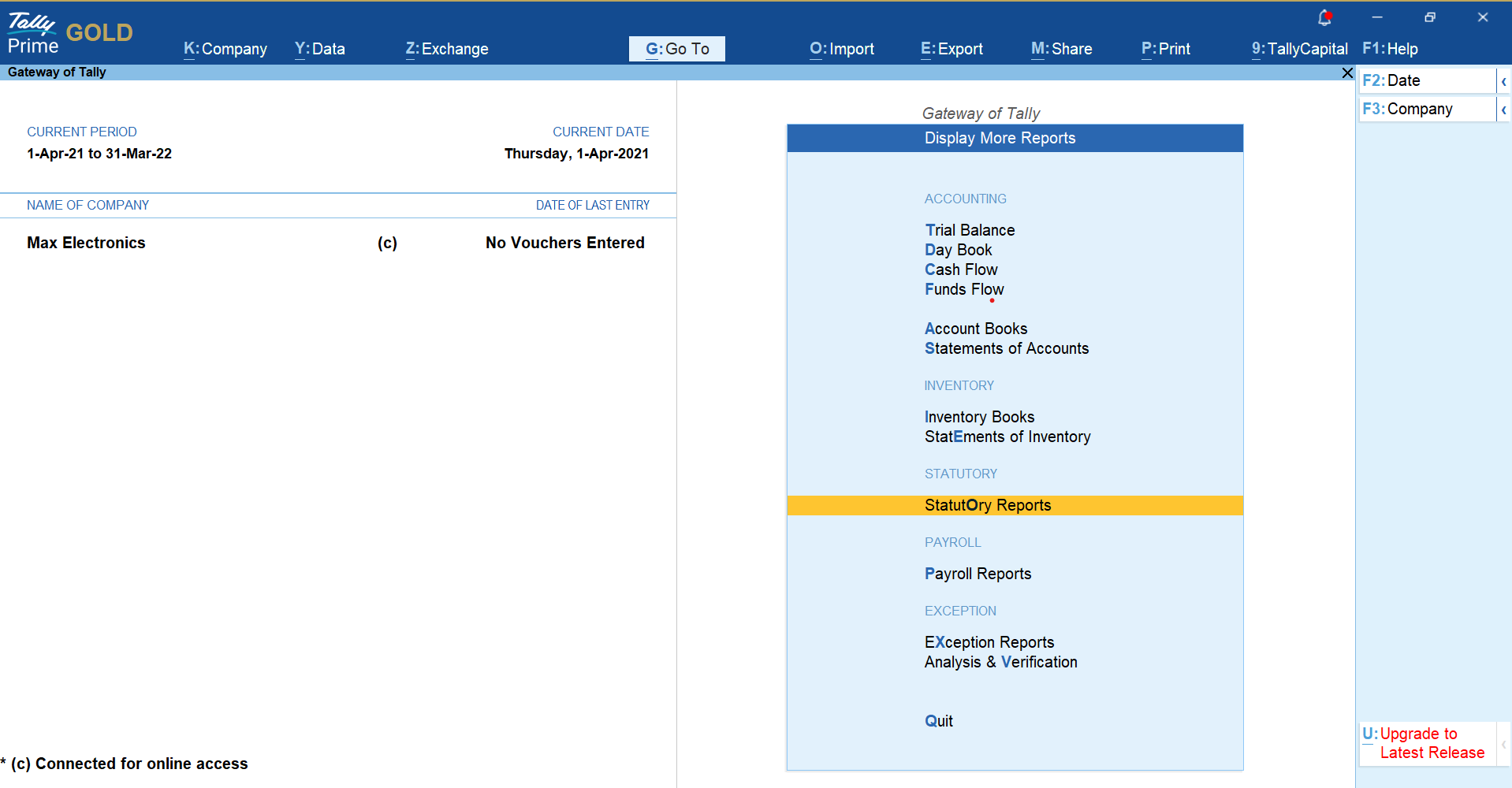

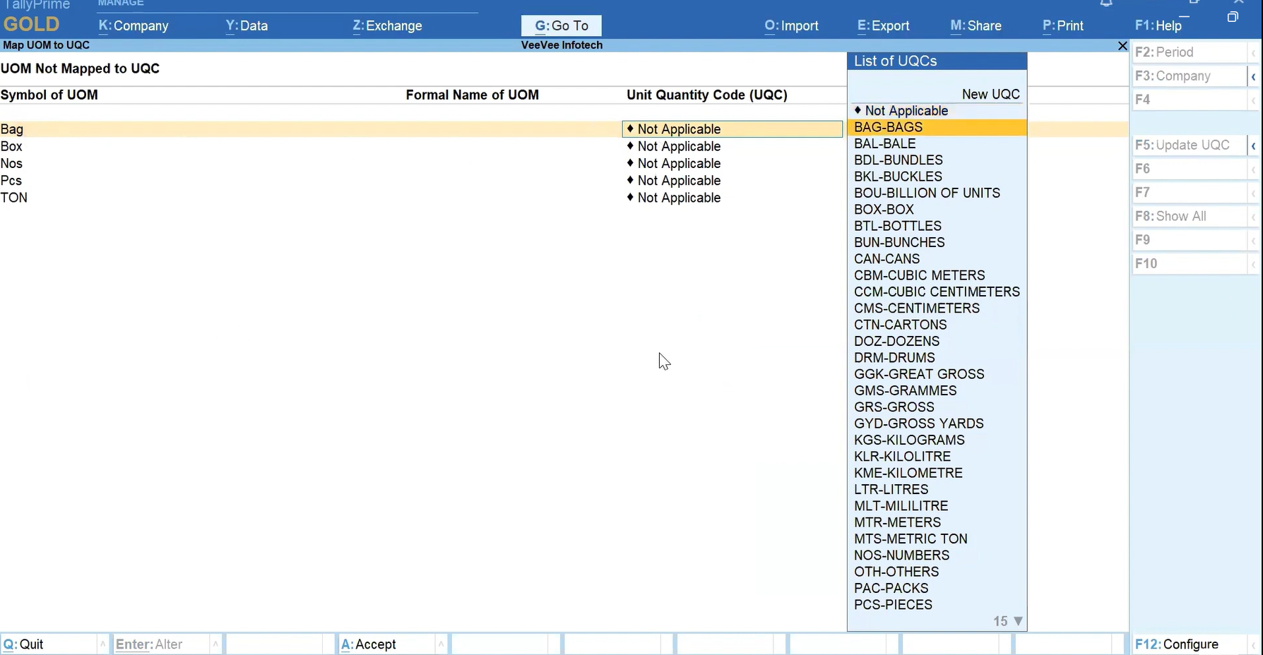

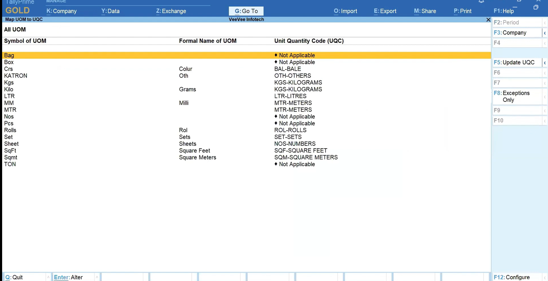

Tax payers should ensure to report the correct UQC in monthly returns, as per the list given. For example, if a tax payer is using the unit of measure as Litres, the same is not listed in the UQC code list. Hence, the tax payer should report the details in the UQC KLR for Kilolitre.
