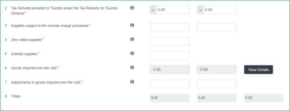

The VAT on sales and other outputs section contains 8 boxes in which the sales and output VAT details need to be furnished to complete the TAX Return filing. The details of boxes available under VAT on sales and all other outputs are given below:
vat on sales details
vat on sales
As shown in the image above, against each box, you need to capture the details in the following columns:
  • Amount (AED): You need to mention the amount in AED relating to sales and other outputs less VAT for each of the Emirates.
  • VAT Amount (AED): You need to mention the output VAT amount levied on your sales for each Emirate.
  • Adjustment (AED): Any adjustments required for Output Tax as a result of adjustments for bad debts, sales of commercial property in the UAE need to be reported here. If these adjustments are not applicable to you, please mention ‘0’.

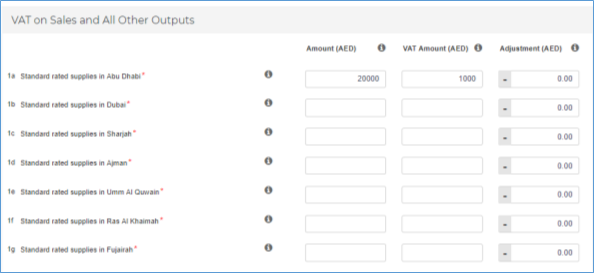

Let us discuss the details required to be captured in standard rated supplies which determines your output VAT liability,
Standard Rated Supplies at Emirates Level
In the above box, the taxpayer is required to declare the net value of standard supplies and applicable output VAT. Standard rated supplies are those supplies that are subject to VAT at 5%. Here, net value refers to the value of the supplies excluding the VAT charged to the customer.
For example, if you have sold goods for AED 1000 plus VAT AED 50, you should report AED 1000 under 'Amount (AED) column and AED 50 under the 'VAT Amount (AED) column.
This information should be identified at the Emirate in which the supply was made and accordingly you need to furnish the details in boxes 1a to 1g.
For businesses with fixed establishments in the UAE, the supply should be reported in the Emirate where the fixed establishment, most closely connected to the supply is located. For non-established businesses, the supply should be reported in the Emirate where the supply was received.
