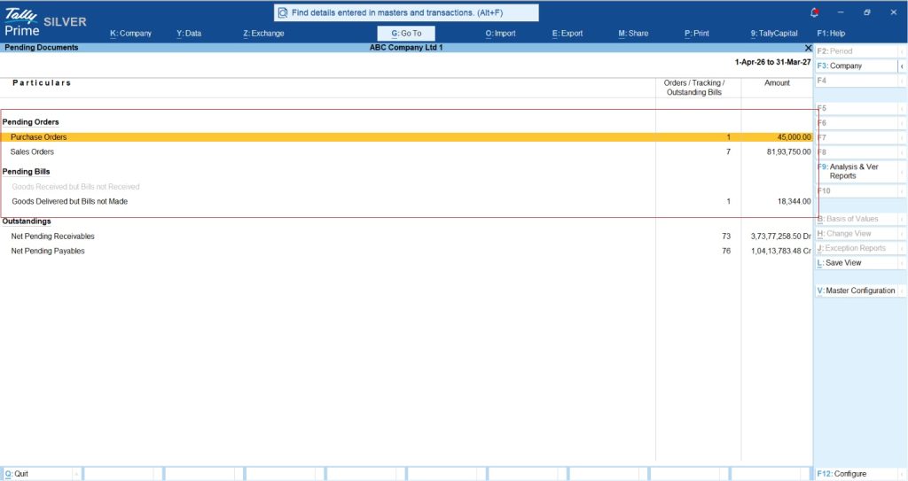

    1. Purchase Order (Ctrl+F9): This is a contract with no financial impact. It raises a demand but does not affect ledgers or stock.
    2. Receipt Note (Alt+F9): This increases physical stock but creates a "Purchase Bills Pending" provisional liability.
    3. Rejections Out (Ctrl+F5): Use this for damaged goods discovered before the bill is booked. It reduces stock and the provisional liability simultaneously.
    4. Purchase Invoice (F9): Critical Step: You must link the Tracking Number from your Receipt Note here. Failure to link tracking numbers is the #1 cause of bookkeeping clutter, it leaves the "Purchase Bills Pending" ledger ballooning even after you have paid the vendor.

    Pending Bills

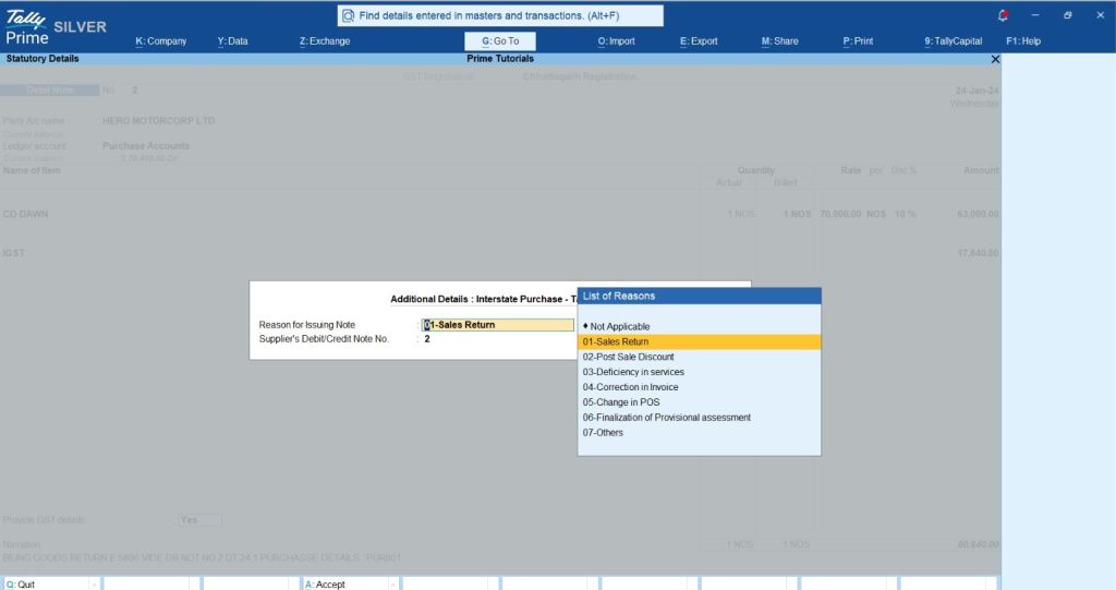

    • Credit note (Alt+F6): Used for sales returns. You must select the "Statutory Reason" (e.g., Sales Return) to ensure GSTR-1 updates correctly and reduces your output tax liability.
    • Debit note (Alt+F5): Used to return goods to suppliers, effectively reversing the ITC you previously claimed.
    Statutory Reason
